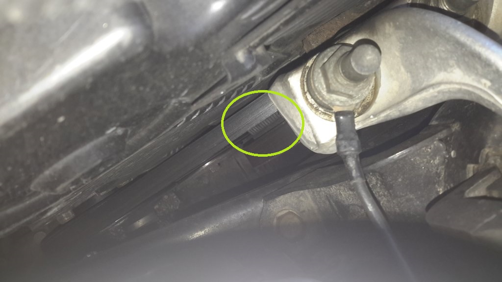

aw_309 14.03.2015 07:22
Here is a picture of my engine..
neo303 14.03.2015 08:22
the v-belt is in bad shape (!) and you lost the part of the cover where the markings for the timing are - a part of the cambelt is not covered which could lead to serious damage!
aw_309 14.03.2015 09:06
Ah, so the mark is on the cover. : - /
Yes I know , I bought the car in this condition and recently received view that they have removed the lower part of the hood. Cheating Jobs . Guess there is lot of work to get a new cover ? Can I set the ignition without cover as long in some way ?
Thank you !
neo303 14.03.2015 10:12
you could create a mask with the markings on your own - if you can get hands on an original cover. but in that case you can install the cover right away too...
maybe Peter Willer can help you (www.xedos-shop.de - link is also on the righthand menu of this forum on the very bottom).
aw_309 14.03.2015 10:17
Is it same cover on Xedos 6 and 323f 2.0 v6? Both KF engine type
neo303 14.03.2015 10:46
not 100% sure, but i think so. K-engines in general are very similar!
