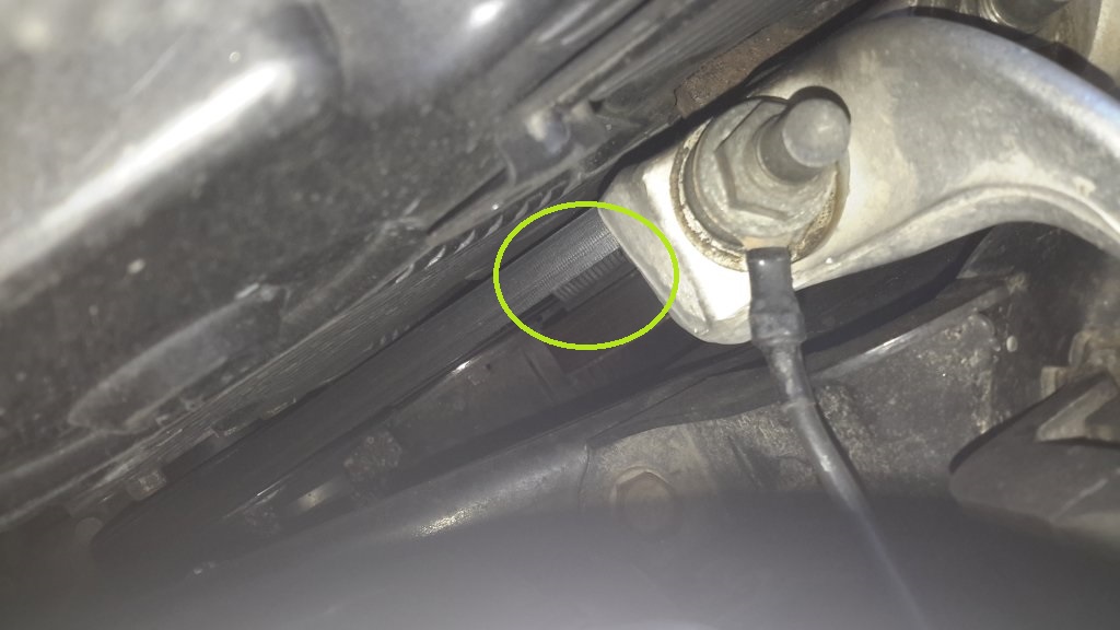

Alt 13.03.2015, 06:11   #4
Beiträge: 2.579
Rexton G4 2.2DTR
Hits:	1076
Größe:	103,3 KB

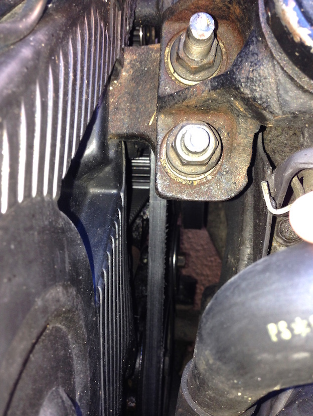

Alt 14.03.2015, 07:22   #5
aw_309
Here is a picture of my engine..
Hits:	1024
Größe:	230,8 KB
Alt 14.03.2015, 08:22   #6
neo303
Registriert seit: 17.03.2009
Beiträge: 1.319
Xedos 9 KL (2.5) '96
the v-belt is in bad shape (!) and you lost the part of the cover where the markings for the timing are - a part of the cambelt is not covered which could lead to serious damage!
Alt 14.03.2015, 09:06   #7
aw_309
Ah, so the mark is on the cover. : - /
Yes I know , I bought the car in this condition and recently received view that they have removed the lower part of the hood. Cheating Jobs . Guess there is lot of work to get a new cover ? Can I set the ignition without cover as long in some way ?
Thank you !
Alt 14.03.2015, 10:12   #8
neo303
Beiträge: 1.319
you could create a mask with the markings on your own - if you can get hands on an original cover. but in that case you can install the cover right away too...
