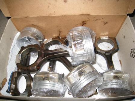

"New" pistons
Look like new, is not it?
In fact, I cleaned them in an ultrasonic bath.

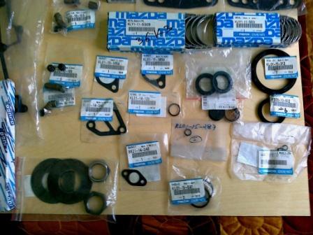

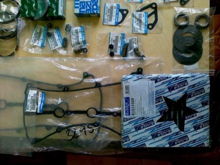

Mazda Genuine parts
Parts are ready.
Engine block heads are going to the specialists.

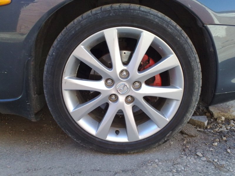

Mazda 6 front brakes
Hello!
Today i put Mazda 6 front brakes.
EBC ceramic brake pads and a little perforated discs.
Brake callipers are fully rebuild, new pistons, rubbers, guides.
They were used about 10000km by another Mazda owner, my friend, mazda clubber.
Amazing difference in braking.
Also changed brake and clutch fluid.

Nice.
Is this plug'n'play?
regards

Nice.
Thanks.
Absolutely. Just buy and put. Nothing to invent.
Discs are from 2.0 - 2.3 Mazda 6 version.
One thing only, stock 15 alloys will need spacer, probably. Or just put 16 inch wheel on winter as i did.
Mit freundlichen Grüßen,
Artem (рус.Артём)
