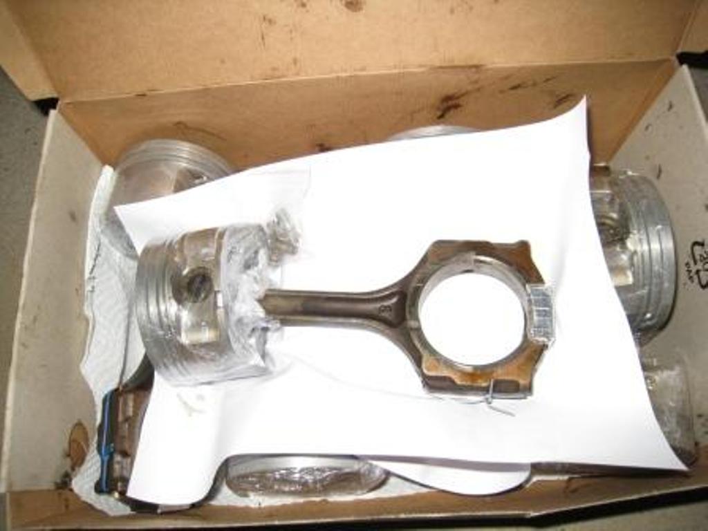

"New" pistons
Look like new, is not it?
In fact, I cleaned them in an ultrasonic bath.

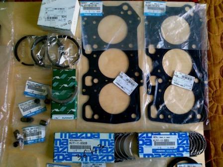

Mazda Genuine parts
Parts are ready.
Engine block heads are going to the specialists.
