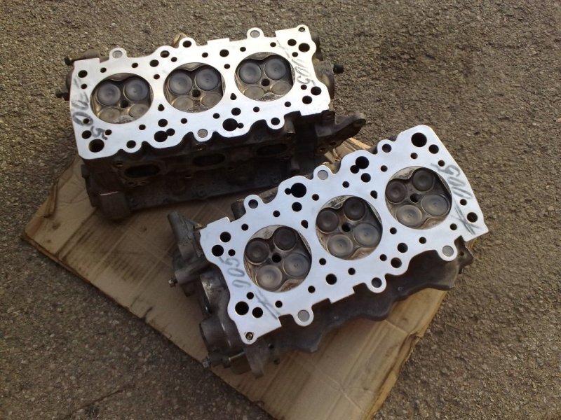

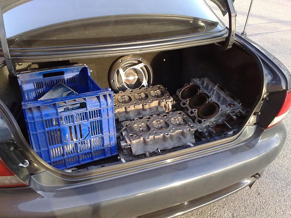

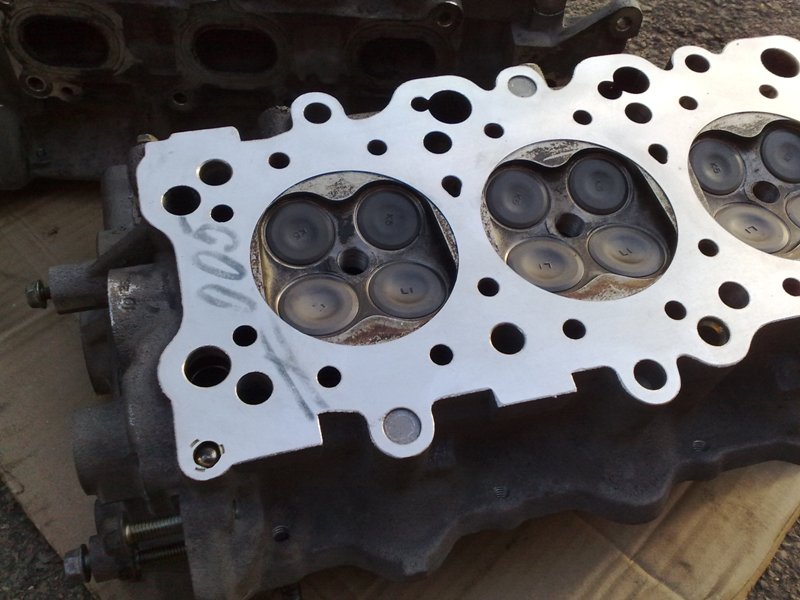

Rebuiled heads
Today took rebuilded heads.
Was made:
1. polished surface
2. new valve guides on exhaust valves
3. polished valves
4. valves and valve seats were machined. Made stock angles. Tested by vacuum.
5. i washed heads using karcher with 100`C temperature

Mit freundlichen Grüßen,

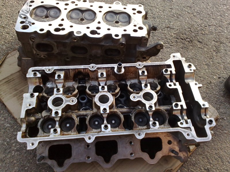

Valve covers
All Saturday spent for cleaning.
Take a look.
I`ll polish them with aluminium paste later.
