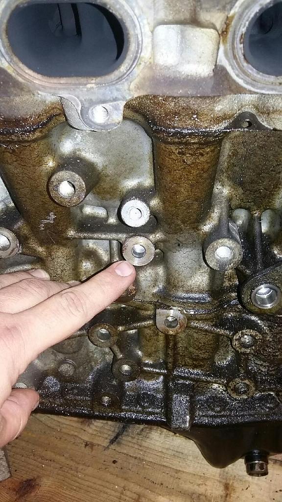

aw_309
the mechanic man says that on the picture (KF 2.0 engine) the finger points at a hole that doesn't exists on the 2.5 engine.
Hits:	292
Größe:	144,6 KB
Alt 17.02.2016, 20:00   #42
Beiträge: 2.512
Shouldn't this part be screwed to the gear box (which indeed is still the same as before)? Or do I remember wrong?
Yes, this is wrong.
The "indermediate axle" will be mounted in the opposite way as shown on the picture. In the gearbox there is only the "teeth-connection" and on the right side there is the bearing. And the body of this bearing should be screwed to the engine block. In my case (Xedos 9 KL manual gear) there where 3 holes, but 2 screws.
@aw_309:
Please confirm: In your case only one hole of the bearing body will match with screwed hole of the block?

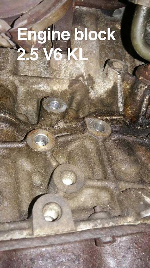

Alt 17.02.2016, 20:06   #43
Beiträge: 2.512
I made numbers to the holes in your picture:
1.) Please confirm, that hole nr. 1 and 2 was screwed at your KF block.
2.) Please confirm, for which hole nr. now is missing screwed hole in the block.
3.) Please check, if at KL block there is a screwed hole at nr. 3.
Alt 17.02.2016, 22:08   #44
aw_309
"In your case only one hole of the bearing body will match with screwed hole of the block?"
Yes the 2.5 block, only one hole will fit the bearing body!
So now i need to buy the bearing body? from a MX-6 (2.5) or ford probe or will Xedos 9 2.5 work??
Possible to modifie the bearing body that i have? :-/ Maby difficult to get this part!!

Alt 17.02.2016, 23:39   #45
hörnchenmeister
Registriert seit: 22.01.2008
Ort: Glauchau
Beiträge: 1.078
Once I did my swap, I had the same problem and I had take the risk to use only one screw.
After 30TKM I had no problems. It make sense to check that screw sometimes.
I think you only need the part from Ford Probe MX6 ore 626GE
Geändert von hörnchenmeister (17.02.2016 um 23:51 Uhr)

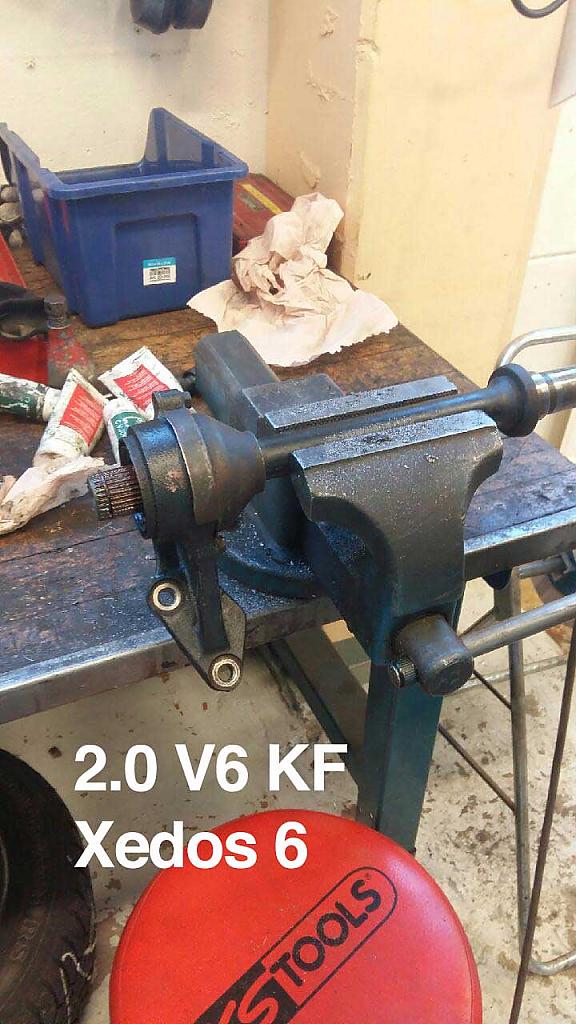

Alt 17.02.2016, 23:50   #46
aw_309
aha only one screw!? sounds scary? :-/
I checked the technical drawings and its a mess!!
They changed all lot during some years.
So now i know that the drive shaft BRACKET, SHAFT JOINT for the 2.5 engine is different then the joint for 2.0. I found out that Mazda 626 and MX-6 has the right 3 holes mount BUT will my other parts on the drive shaft work? i got new joint set outer.
ALSO the bearing balls needs to change to new one!
ohhhh when will my car be ready... i hope soon!! = )
Geändert von aw_309 (18.02.2016 um 00:00 Uhr)

aw_309
PICTURES!!
Hits:	291
Größe:	129,0 KB
ID:	8193   Klicke auf die Grafik für eine größere Ansicht
Hits:	288
Größe:	101,5 KB
Alt 18.02.2016, 09:11   #48
aw_309
yes (hörnchenmeister) looks like that will fit!! =)
maby i just do like you with one bult!
Alt 18.02.2016, 09:55   #49
hörnchenmeister
Ort: Glauchau
Beiträge: 1.078
Another option would be to drill the hole bigger and cut a bigger thread in the engine block. Otherwise you can use helicoil ore threaded bushings.

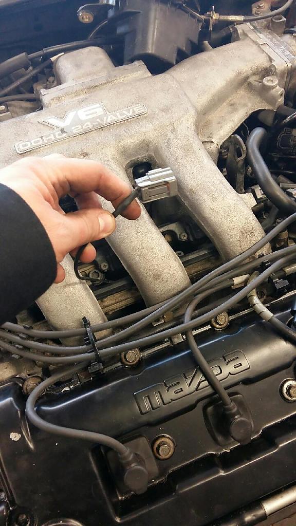

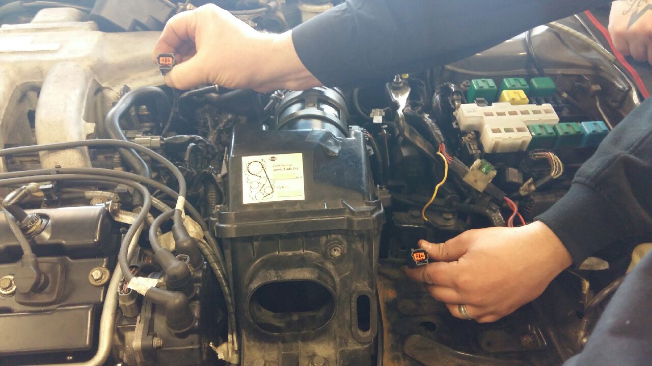

Alt 18.02.2016, 10:25   #50
aw_309
What is this connections for?
now when they almost is done with the engine swap the have two electric connections they don't understand fully.
Do you see what it could be?
The grey is near the top and it goes under some place and the black to the right comes from gearbox.
hmmmm :-/
Anyone?
THANKS!
