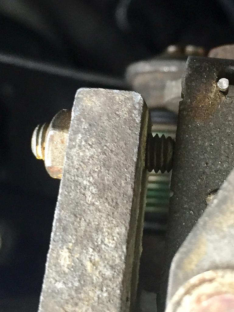

Alt 10.03.2016, 14:33   #7
aw_309
Yes!
What do you think of my setting ( se picture)
What ive red is that this scruv should barely touch the gas throttle but
Here its very more than that.
I will do a real deafult setting tomorow from the guide!

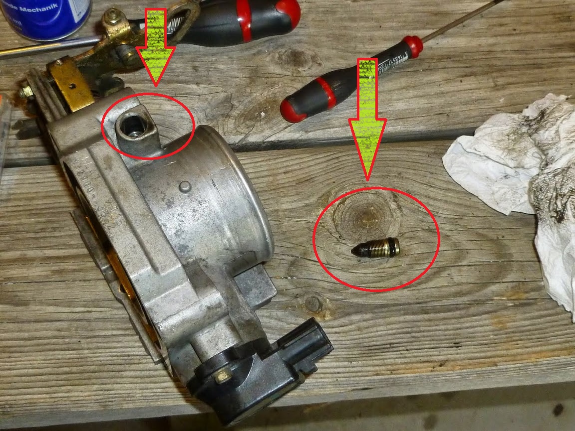

Alt 10.03.2016, 18:33   #8
Beiträge: 2.428
This is not the screw I was talking about....
This is the idle adjusting screw I was talking about:
The screw you marked (left one, red marked) shouldn't be changed. But you can adjust the other one if there is a tolerance (right one, green marked).
