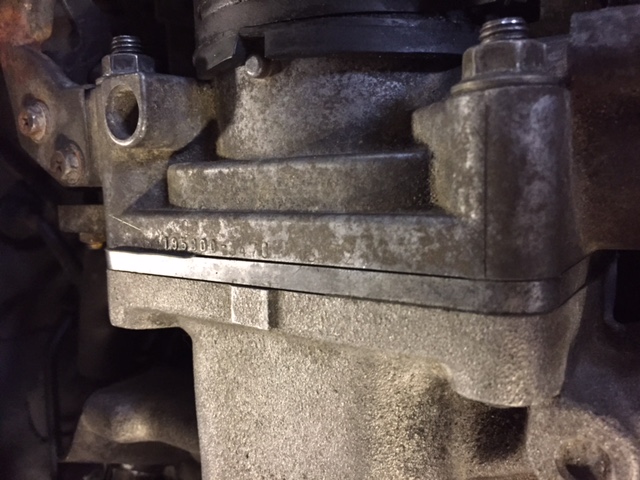

Lite bit hard to explaine but ill try again = )
on Xedos 6 where the Trottle body is located there is a metal plate between the
intake manifold to the throttle body.
INTAKE MANIFOLD ---> metal plate (with four screw) ------> Throttle body
On the 2.5l V6 (mx6, 626 Ge, ford probe) they use no metal plate.
Will the car go better without the plate?

Alt 18.03.2016, 10:47   #63
Beiträge: 2.514
How thick is the plate? Which material? Which color?
Maybe you mean the metal gasket....
If yes, there should always be a gasket!

aw_309
Its not a gasket!
Plate, about 5mm thick.

Alt 18.03.2016, 17:49   #65
aw_309
Metal plate
Hits:	596
Größe:	118,2 KB

Beiträge: 2.514
Aha, interesting!
And there are then 2 gaskets?
I guess it is only because of distance problems. I see no other reason to mount such plate.
The plate has no other holes? Or something other is attached to the plate?
