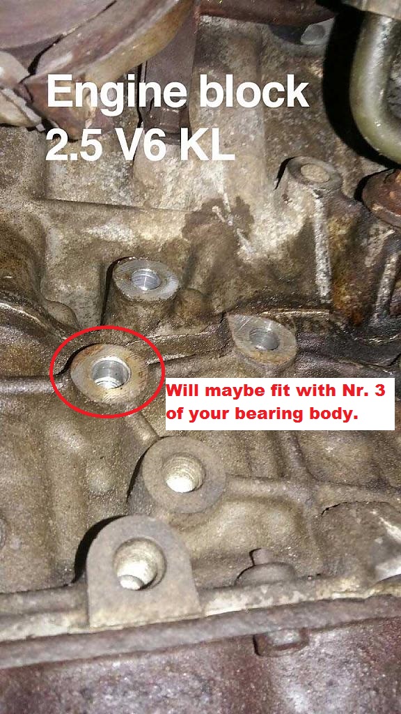

Alt 18.02.2016, 12:04   #52
Beiträge: 2.505
Zitat von aw_309 Beitrag anzeigen
"In your case only one hole of the bearing body will match with screwed hole of the block?"
Yes the 2.5 block, only one hole will fit the bearing body!
Have you checked Nr. 3?
As below:
3.) Please check, if at KL block there is a screwed hole at nr. 3.
If at hole Nr. 3 there is a screwed hole at the block you could drill a hole in the bearing body and use that for second screw.
Alt 18.02.2016, 12:09   #53
Beiträge: 2.505
Please check. Maybe this hole will fit with Nr. 3 of your bearing body:
Alt 19.02.2016, 10:31   #54
aw_309
Yes i will check! = )
